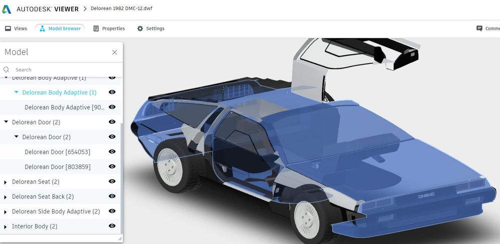

Hi there, I am testing the Autodesk viewer. I upload a DWF file created from Revit and this is the result I am getting. It is missing surface. I've included the DWF file to see if your software engineer can resolved the issue. Thanks.

This was created in Revit 2017. I do notice this happens a lot with adaptive surface. One side will show up with material while another side shows up as transparent. Unfortunately within revit, you cannot define which side you want the material to show up.

car part missingcar part missingThe problem is that the 'body adaptive part' has multiple layers, can try putting them separately (front and back). I'll also test it in Revit to see if we can group them.

The issue is the Autodesk viewer is built with positive and negative side in mind. From what see and play around, to keep the refresh rate acceptable, getting rid of the negative side helps the engine runs faster. Unfortunately within revit, you cannot define which side is positive or negative. Hopefully your engineer team can add a feature in Autodesk viewer to show both material surface instead of one.

Do send us your journal file when you have a chance. the model appears fine in viewers - truview and design review so, with the normals flipped in the online viewer, the materials appear transparent when viewing. Using explode control shows that the material is applied on only one side.

On loading the model into ACAD or 3ds Max, the same problem can be seen. Here, 3ds Max shows the normals in blue which highlights the fact that the surfaces in the source model are inconsistent. This can be mitigated with 2-sided materials, but the best solution would be to unify the normals in the model itself.

One of the engineers suggested the below workaround, for now, please try and let me know if you have any questions.
(Open A360 online viewer, launch model and right click on page > click inspect - it will open the console)
In the browser development console, enter the following:
NOP_VIEWER.impl.matman().forEach(function(mtl) { mtl.side = THREE.DoubleSide;})
Browser dev consoleBrowser dev console
Click inside the viewer and you should be able to see all the surfaces.
What the syntax fix does is that it forced to change the double-sided geometry to shows ALL materials to double-sided, which was set to false before (i.e allows only one-sided materials)

Thanks for the workaround. I test it on chrome & firefox, both works. Once I close the chrome browser, I have to re-enter the code. It can be annoying for the user who aren't computer savvy.
