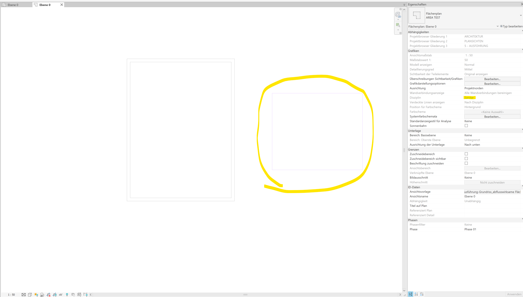

I'm encountering an unusual issue with the visibility of area boundaries.
I'm working in a ground floor with an activated view template that sets the discipline to "plumbing."
I can draw my area boundaries, but as soon as I finish drawing, they disappear.
Initially, I suspected it was due to the discipline setting. However, when I add a toposurface to the project, the boundaries become visible. Conversely, if I remove the toposurface, the boundaries disappear instantly.
Could someone please clarify this phenomenon?

I am sorry, i wasn´t clear.
i work already in an area plan.
Sorry. I misread you. Post your RVT here.
....Are you sure it's not visible? Area Boundaries should show as Halftone in Plumbing Discipline.

Unortunately, I can´t post the original file.
I just startet a new file and tried to reproduce the bug. Now everthings works fine.
Area boundaries are now in Halftone.
Thanks for jour help!
You had to start a brand new Project to resolve???  That's a little extreme - as well as impractical.  I'm sure there's a resolution that doesn't involve starting a Project all over from scratch. I'm sure it's not a "bug". I would bet money that it's a Project setting.
BTW: if it is a "Bug" like you think (I  don't), wouldn't the same thing eventually happen again in this new Project?

No i do not have to start a new projekt.
As i said, the area boundaries just dissapear when there is no toposolid in the project.
I attached a video, for me it still looks like a bug.
