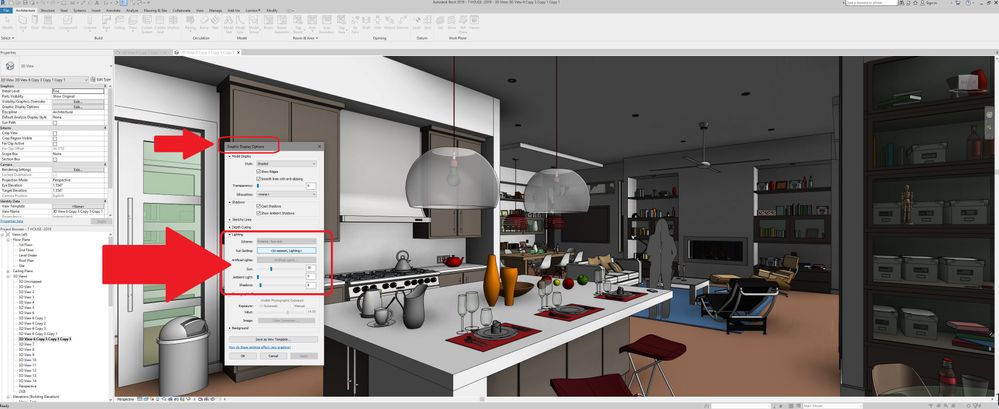

....... YES..... there is a way to control the intensity of shadows and exposure.
..... go to your view
......open graphic display options
...... style : whatever you wamt
..... show edges, smooth lines with anti-aliasing
... cast shadows
... show ambient shadows
.... and then:
... go down and open Lighting
... in here if you tweak these sun , ambient light and shadows you will get the ambient shadow that you want.

....  the question is: How do I control the darkness of the Ambient Shadows?
... to me it's pretty clear that I can control those shadows from the lighting in graphic display options
.... look how clear can get keeping the idea of the ambient shadows
