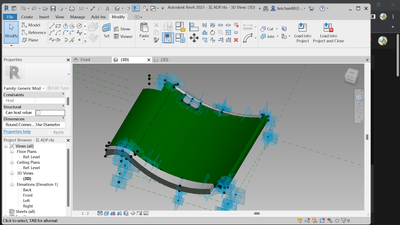

Hello, I made an adaptive tile with 4 adaptive points only (other points all hosted). Then when place on a mass, there are two problems
(1) only 2 adaptive points are recognized on roof nodes, i,e, unable to place 4 adaptive points on 4 nodes
(2) after  repeater, many tiles are missing with error message "delete instance"
this is the final frontier of this BIM model before completed.
Please advice, thanks

Below two screenshots show two different 4-pt. Adaptive Point Repeater Families on the exact same divided lofting surface. One Repeater Family’s Adaptive Points are oriented by “Instance (x,y,z)” and the other Repeater Family’s Adaptive Points are oriented to “Host and Loop System (x,y,z)”.  Repeater Families are identical in every other way.  You be the judge of which of the two Adaptive Point orientations perform best.
Instance (x,y,z):
Host and Loop (x,y,z):

Anybody reading this thread can weigh in.  Does one Adaptive Point orientation look like it performs better than the other?

Since I acknowledged that: 4 AP is over-designed for tile, which profile shall be fixed but not flexed at 4 corners. So now i have simplified not using 4 APs, and turn to the approach of  (1) 2-AP fixedprofile then (2) nest to pattern then (3) load to roof see my new post https://forums.autodesk.com/t5/revit-architecture-forum/trimming-perfectly-of-pattern-based-tile-par...
