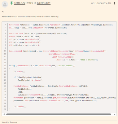

Here is the code if you want to review it, there is no error handling.
Reference reference = uidoc.Selection.PickObject(Autodesk.Revit.UI.Selection.ObjectType.Element);
Wall wall = (Wall)doc.GetElement(reference.ElementId);
LocationCurve location = (LocationCurve)wall.Location;
Curve curve = location.Curve;
XYZ p1 = curve.GetEndPoint(0);
XYZ p2 = curve.GetEndPoint(1);
XYZ midPoint = (p1 + p2) / 2;
FamilySymbol familySymbol = new FilteredElementCollector(doc).OfClass(typeof(FamilySymbol))
.WhereElementIsElementType()
.Cast<FamilySymbol>()
.First(x => x.Name == "0406 x 0610mm");
using (Transaction tr = new Transaction(doc, "Insert Window"))
tr.Start();
if (!familySymbol.IsActive)
familySymbol.Activate();
FamilyInstance familyInstance = doc.Create.NewFamilyInstance(midPoint,
familySymbol,
wall,
(Level)doc.GetElement(wall.LevelId), StructuralType.NonStructural);
Parameter parameter = familyInstance.get_Parameter(BuiltInParameter.INSTANCE_SILL_HEIGHT_PARAM);
parameter?.Set(UnitUtils.ConvertToInternalUnits(500, UnitTypeId.Millimeters));
tr.Commit();

Hi @supportS8CPF Things to keep in mind.
--> Make Sure the Point is on the window's Location Curve.(You can get it by getting the midpoint using Endpoint(0&1)
--> As per the method u posted i can see u trying to set structuralType.Beam, Keep it as StructuralType.NonStructural
And for your reference here Mr. @Speed_CAD posted the complete code which will certainly solve your issue.
