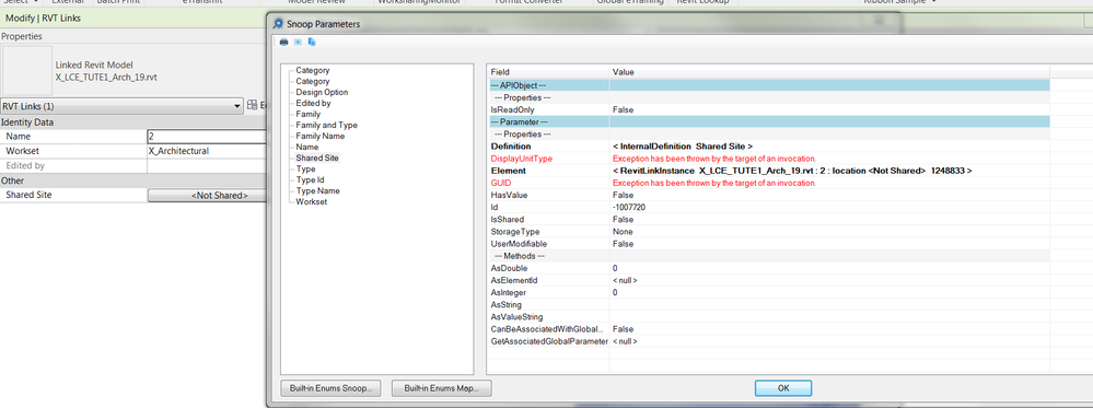

I am attempting to make a site coordination automation with dynamo, unfortunately I cannot find the shared site property for link instances in the API https://www.revitapidocs.com/2020/b3f65a42-c810-e864-7f4e-438dd2ea2679.htm
The parameter also will not show in dynamo although it was defined. (Likely due to its absence in the API)
see attached image
Is there a reason for this omission?
-Thanks

465565873s
In attempt to achieve the same function as a Revit addin, I found a shared site builtInParameter "GEO_LOCATION". However, I haven't found a way to somehow change this parameter.
Screenshots shows change in shared site value.
H.echeva
Recently I had the same question and couldn't find an answer. However, as the previous reply, if you use the name of the link instance you can get the name of the shared position or if it is not shared. Not ideal, I know.
lcunninghamAGG8H
I found that you can modify this field via creating and publishing project locations/positions. However, there is nothing in the API that allows you to unclip the survey point or basepoint, therefore making full automation practically impossible. (because you can never change the location of the survey point relative to the model)
https://forums.autodesk.com/t5/revit-ideas/clip-unclip-survey-point-and-base-point-via-api/idi-p/911...
Take this into account when you develop your solution so that you waste your time assembling a 1000 pc puzzle where the final piece doesn't fit, like I did.
