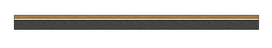

Hi!
I'm currently working with Revit Wall layers and trying to get the geometry information from each layer. I found a solution on Jeremy's blog using PartUtils.GetAssociatedParts() to solve the problem: http://thebuildingcoder.typepad.com/blog/2011/10/retrieving-detailed-wall-layer-geometry.html
This approach works great for layers without wrapping and joint walls, but it fails to detect the wrapping part.

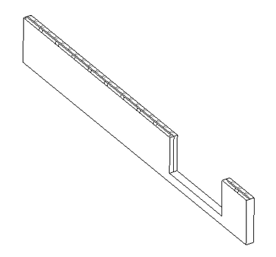

I attached the wall with layers named WrappingLayerWall.png, and the result using Create Parts Tool in Revit (same as the PartUtils API😞 CreateParts.png in attachments.
In this case I have no way to tell if or where the layers are wrapped since it fails to return the wrapping information.
Is there any way that we can separate the wall by different materials?  Otherwise do you have any suggestions on retrieving wrapping layer geometry?

Hey Jeremy,
I think I didn't describe my question clear enough.
The approach we mentioned works great for joint walls, but I don't think it works for wrapping layers in a single wall panel.
The PartUtils.GetAssociatedParts() will separate wrapping layers into straight layers.
I'm not sure if it's the same in previous API versions but at least in Revit API 2016 and 2017 it behaves like this:
PartUtils.GetAssociatedParts() will get the wrapping layers into straight layers:
So is there any way for us to retrieve the points highlighted in red for wrapping layers?
Thanks a lot for helping!
Best,
Siwan
Message 7 of 12
jeremytammik
Yes, that is easy.
Those points can be determined by looking at the wall location line, offset from the location line, and thickness of each of its layers.
Simply imagine lines along each layer boundary and calculate their respective intersection points.
Cheers,
Jeremy

Message 8 of 12
Oh right that sounds good, and we can determine if the layer is being wrapped by checking layerCapFlag parameter.
Thanks again Jeremy.
Message 9 of 12
FAIR59
I don't think you can determine how far the layers get wrapped that way. For Windows / Doors that value is determined by the named reference plane " Int Wrap Plane "and Ext Wrap Plane", it need not be half the wall width.
The layer information in the model seems to be only a "2D hatch" applied to the cutplane of the wall. That 2D information isn't available in the regular API.
Given that the information gets exported to DXF/DWG, you could try retrieving the info from a CustomExporter, though I haven't tried that yet.
Or you could isolate the wall in a plan view and export to DXF, and try and read the DXF file for the line information.

Message 11 of 12
FAIR59
Wrapping is indeed always with the thickness of the layers.
I was commenting on the other axis. With inserts can the wrapping stop before the Finish Face Interior. ( added black line).  Your picture looks like wrapping at the end of the Wall, then the thicknesses will be the same and stops at the inside face of the wall.
For your information:
The "wrap layers" may be cut by the inserts, resulting in irregular shaped faces. In the next picture the outer wrap layer is shorter and the cavity wrap layer gets "squeezed".
