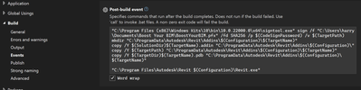

One thing I've found is that the old-style PostBuildEvent doesn't work in the new-style CSPROJ
This used to work
    <PostBuildEvent>"C:\Program Files (x86)\Windows Kits\10\bin\10.0.22000.0\x64\signtool.exe" sign /f "C:\Users\harry\Documents\Boost Your BIM\BoostYourBIM.pfx" /fd SHA256 /p $(CodeSignPassword) /v $(TargetPath)
mkdir "C:\ProgramData\Autodesk\Revit\Addins\$(Configuration)\$(TargetName)"
copy /Y $(ProjectDir)$(TargetName).addin "C:\ProgramData\Autodesk\Revit\Addins\$(Configuration)\"
copy /Y $(TargetPath) "C:\ProgramData\Autodesk\Revit\Addins\$(Configuration)\$(TargetName)"
copy /Y $(TargetDir)$(TargetName).pdb "C:\ProgramData\Autodesk\Revit\Addins\$(Configuration)\$(TargetName)"
"C:\Program Files\Autodesk\Revit $(Configuration)\Revit.exe" "C:\Users\harry\Documents\rvt\2023.rvt"</PostBuildEvent>
When updating this project, delete that section from the CSPROJ and enter the code in here
The result will be this entry in the CSPROJ
  <Target Name="PostBuild" AfterTargets="PostBuildEvent">
    <Exec Command="&quot;C:\Program Files (x86)\Windows Kits\10\bin\10.0.22000.0\x64\signtool.exe&quot; sign /f &quot;C:\Users\harry\Documents\Boost Your BIM\BoostYourBIM.pfx&quot; /fd SHA256 /p $(CodeSignPassword) /v $(TargetPath)&#xD;&#xA;mkdir &quot;C:\ProgramData\Autodesk\Revit\Addins\$(Configuration)\$(TargetName)&quot;&#xD;&#xA;copy /Y $(SolutionDir)$(TargetName).addin &quot;C:\ProgramData\Autodesk\Revit\Addins\$(Configuration)\&quot;&#xD;&#xA;copy /Y $(TargetPath) &quot;C:\ProgramData\Autodesk\Revit\Addins\$(Configuration)\$(TargetName)&quot;&#xD;&#xA;copy /Y $(TargetDir)$(TargetName).pdb &quot;C:\ProgramData\Autodesk\Revit\Addins\$(Configuration)\$(TargetName)&quot;&#xD;&#xA;&#xD;&#xA;&quot;C:\Program Files\Autodesk\Revit $(Configuration)\Revit.exe&quot;" />
  </Target>
try to use this package https://github.com/Nice3point/Revit.Build.Tasks and add these lines if you just want to copy files:
<PropertyGroup>
    <PublishAddinFiles>true</PublishAddinFiles>
</PropertyGroup>
or copy target directly in your .csproj file:
https://github.com/Nice3point/Revit.Build.Tasks/blob/main/source/Nice3point.Revit.Build.Tasks/target...
I recommend to always use Target instead of PostBuildEvent

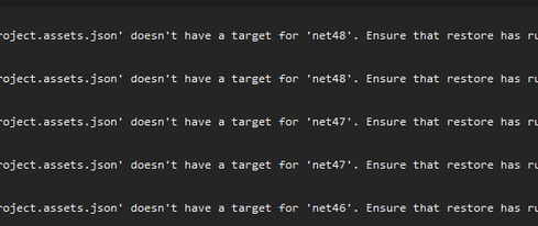

Hi guys, please look at how I managed to change my project to a sdk-style: https://github.com/Tereami/ArchParametrisation/blob/master/ArchParametrisation/ArchParametrisation.c...
Everything works ok, but with one exception: Batch build didn't work now, catches an error
NETSDK1005 Assets file 'project.assets.json' doesn't have a target for 'net47'.
In the same time, every configuration separately builds ok! I've tried to delete .vs and obj folders, restart my computer, upgrade msbuild and nuget, doesn't help.
