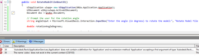

This is my attempt (but with errors [attached])
using System;
using Autodesk.Revit.UI;
using Autodesk.Revit.DB;
using Autodesk.Revit.UI.Selection;
using System.Collections.Generic;
using System.Linq;
using Microsoft.VisualBasic; // Importing Microsoft.VisualBasic for InputBox usage
namespace DDA_CSharpModule4
[Autodesk.Revit.Attributes.Transaction(Autodesk.Revit.Attributes.TransactionMode.Manual)]
[Autodesk.Revit.DB.Macros.AddInId("8469C11C-9426-4B76-8910-02E720C07230")]
public partial class ThisApplication
private void Module_Startup(object sender, EventArgs e)
RotateModelFileAboutIO(); // Call RotateModelFileAboutIO on startup
private void Module_Shutdown(object sender, EventArgs e)
#region Revit Macros generated code
private void InternalStartup()
this.Startup += new System.EventHandler(Module_Startup);
this.Shutdown += new System.EventHandler(Module_Shutdown);
#endregion
public void RotateModelFileAboutIO()
UIDocument uidoc = this.Application.ActiveUIDocument;
Document doc = uidoc.Document;
// Prompt the user for the rotation angle
string angleInput = Interaction.InputBox("Enter the angle (in degrees) to rotate the model:", "Rotate Model File About Internal Origin", "0");
if (!double.TryParse(angleInput, out double rotationAngleDegrees))
TaskDialog.Show("Error", "Invalid angle entered. Please enter a numeric value.");
return;
// Convert the rotation angle to radians
double rotationAngle = rotationAngleDegrees * (Math.PI / 180.0);
// Get the internal origin point as the center of rotation
XYZ centerPoint = XYZ.Zero;
// Define the rotation axis (Z-axis)
Line rotationAxis = Line.CreateBound(centerPoint, centerPoint + XYZ.BasisZ);
// Collect all elements that can be transformed
FilteredElementCollector collector = new FilteredElementCollector(doc)
.WhereElementIsNotElementType();
List<ElementId> elementIds = new List<ElementId>();
foreach (Element element in collector)
// Skip certain elements that are not transformable (e.g., levels, views, phases, grids)
if (!(element is Level) && !(element is View) && !(element is Phase) && !(element is Grid))
elementIds.Add(element.Id);
// Start a transaction to rotate the model
using (Transaction transaction = new Transaction(doc, "Rotate Entire Model"))
try
transaction.Start();
// Rotate all collected elements around the internal origin
ElementTransformUtils.RotateElements(doc, elementIds, rotationAxis, rotationAngle);
transaction.Commit();
TaskDialog.Show("Success", string.Format("The model has been successfully rotated by {0} degrees about the internal origin.", rotationAngleDegrees));
catch (Exception e)
transaction.RollBack();
TaskDialog.Show("Error", string.Format("An error occurred while rotating the model: {0}", e.Message));

Hi @dwightduronidavy
Kindly follow below steps.
  1. Add Microsoft.VisualBasic reference to the project
  2. Call Input Box Method and pass the parameters.
string angleInput = Microsoft.VisualBasic.Interaction.InputBox("Enter the angle (in degrees) to rotate the model:","Rotate Model File About Internal Origin","0");​
Complete Code for Reference (Errors Resolved)
			string angleInput = Microsoft.VisualBasic.Interaction.InputBox("Enter the angle (in degrees) to rotate the model:", "Rotate Model File About Internal Origin", "0");
			double rotationAngleDegrees;
			if (!double.TryParse(angleInput, out rotationAngleDegrees))
					return;
				try
				} catch (Exception e)
 Hope this will helps 🙂

Hi @dwightduronidavy :
this is my code , can be run in revit .
you code problem is the reference not import
you can try this or  @Mohamed_Arshad code to test .

Hi Mohamed, i got the below error:
Message 14 of 15
Mohamed_Arshad
Try check below code snippet
Code Snippet
UIApplication uiapp= new UIApplication(this.Application);
UIDocument uidoc=uiapp.ActiveUIDocument;
Document doc= uidoc.Document;

dwightduronidavy
PERFECT! Thank you so very much Mohamed and  scgq425
