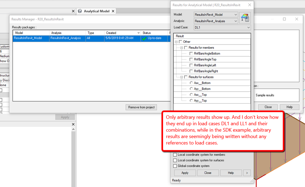

I was trying to store some structural analysis results, but failed to see the results/diagrams inside Revit after writing the data. So I went back to the SDK examples that usie ResultsBuilder, and cannot even get that to work. Or maybe I don't know how to retrieve the results that are stored using resultsPackageBuilder.SetBarResult in Revit UI.
To reproduce my problem, I changed the sample code to only write the linear results for a stick element (column) in the ResultsInRevit.rvt model that comes with Structural SDK:

The results are being written for load cases DL1 and LL1. Running this example in Revit on ResultsInRevit.rvt goes through without any errors. But when I want to actually see these results in Revit, it does not show anything for any of the elements/load cases.
Interestingly, adding arbitrary results seems to work, but that is not something that I want at the moment.

Answering the first question:
When calling the AddLinearResult function, the result package is set as type of  ResultsPackageTypes.All.
The ResultsPackageTypes.Static type package should be used here because the static analysis results are saved in this function
Answering the second question:
Inside function AddArbitraryResults is calling the method with parameter which saying that  results are not dependent on load cases.
In the case of saving the reinforcement results, it is preferable to create a new package that will contain results for reinforcement.
