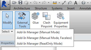

Copy them to "C:\Users\<<USERNAME>>\AppData\Roaming\Autodesk\Revit\Addins\2015" and launch Revit. It should appear like in the image below.
Let me know if still not working for you...

Message 10 of 34
Yes I still have the same problem.
I followed the directions here but they are not sufficiently detailed given that there are so many problems and there are no error messages to help indicate what is wrong.
Your screen capture the expected result seems to conflict withe the standard documented expected result where the "external tools" button is usually in the addins tab beside modify.
Anyway I can't find the "external tools" button anywhere.
Any help would be appreciated.
Message 11 of 34
bcampbell11
After pointing the .addin file to the correct location, I get the same menu that is in your screen capture.
So, it is running from Revit 2015 like it should, but when I run the add-in manager and instal a new add-in, it puts the add-in into Revit 2014.  Please let me know if the sentence in bold is still unclear and I will try to elaborate.
Please take a look at your AddInManager.dll file, I believe it needs to be updated to actually put the plug-in into Revit 2015, NOT 2014!!!

Message 12 of 34
augusto.goncalves
Thanks for reporting it! Indeed the 'Save' feature seems to place the files on 2014 folder, I'll investigate it deeper.
