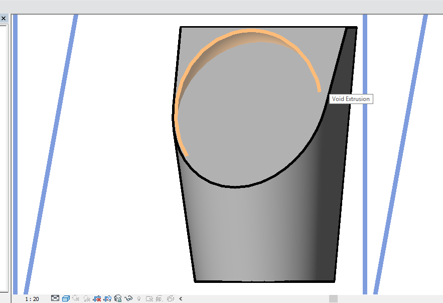

If I manually create a "void extrusion" using the user interface, the generated object automatically cuts the existing blend.
If I set solid to false when creating the extrusion (with blend existing), it displays but does not effect a cut.

I've looked further and found the Document.CombineElements method.
This works for me for the first operation, to create the blend and then cut with extrusion.
Then I add an ellipse revolution, and try to call on the combine elements with the previous result and it doesn't work.
Actually i can't get this api generated revolution to cut manually (where as when I created the family manually it did).
I've attached the family created from the user interface, the resulting family from the API and the resulting family from the API code.
Is sequential calls to combine elements fine?  Anyone spot anything incorrect?

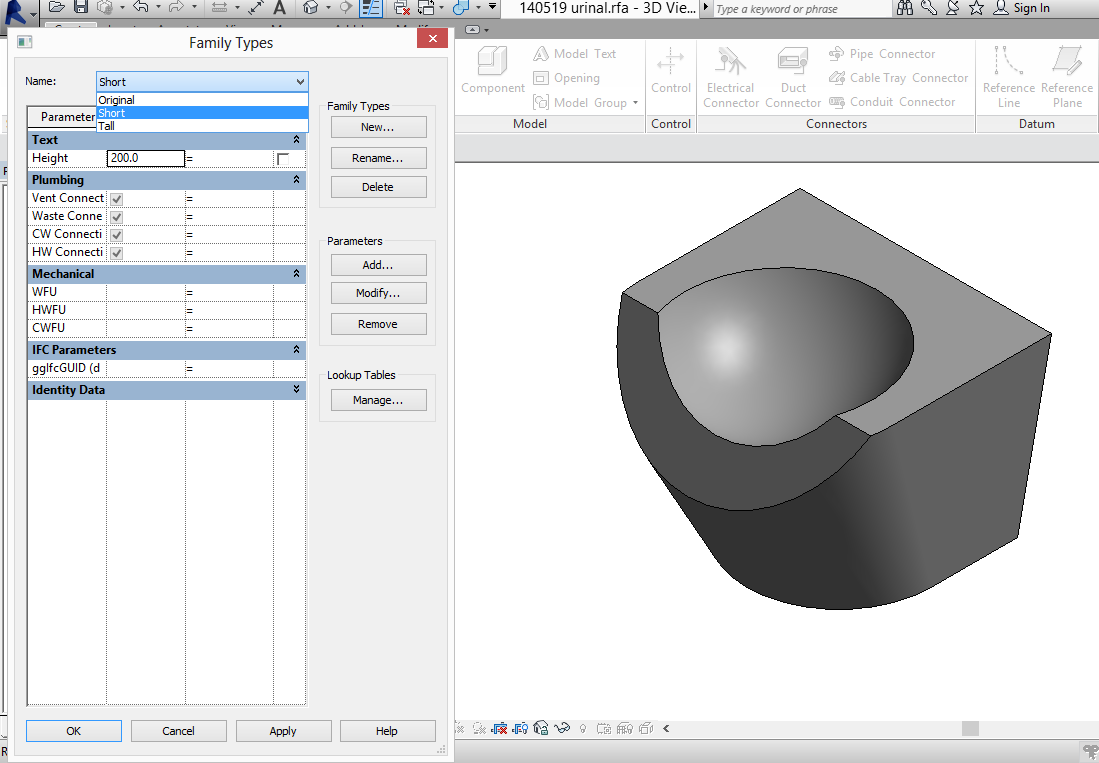

I found if you change the blend depth (there's a parameter in the attached or select the short type), then the both voids are active.
But the manual family I created worked fine so I'm not sure if this is an API issue or something in core revit.
