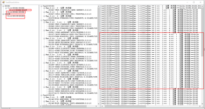

1368026189
the picture above shows the issue,
as for the leaf node linkinstance  4.rvt ,we do not know who holds it.
