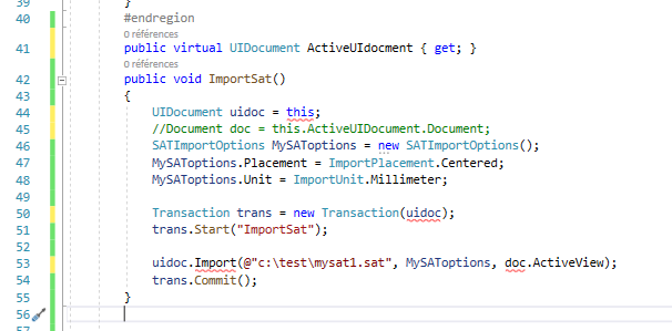

I'm trying to import with the Revit API multiples SAT files that I'have created with Dynamo into Revit. Because with Revit it is possible to import a SAT file but it's only one by one. So my goal is to use Revit API to create a Ribbon Button that select a directory and import all SAT files into the active document.
I have successfuly created a Ribbon Button and i have tried to follow this topic : https://forums.autodesk.com/t5/revit-api-forum/import-sat-files-from-the-api/td-p/3902783
to import just one file but i can't get the active document and visual studio say that it is impossible to convert from Autodesk.Revit.UI.UIDocument to Autodesk.DB.Document.
Do you have any idee how can i succeed ?
I'm new with Revit API and c# sorry for the mistakes ...

To get Document from UIDocument it is: UIDocument.Document

You have actually commented the line in your code snippet visible in posted image.

Hello @RPTHOMAS108 ,
I have these two libraries : Autodesk.Revit.UI; and using Autodesk.Revit.DB.
When I write UIDocument I don't have .Document...
Do you have any idea why ?

Hello @lukaskohout ,
Thank you for answer. It was wanted, I commented it because it wasn't working. When I copy the exact same code as the topic i got these two erros :erros 2.PNG
Do you have an other idea ?

For ambiguous reference try this:
Autodesk.Revit.DB.Document doc
 But firstly I would check if you need the Autodesk.Revit.Creation reference.
For the second error, you have to pass the UIDocument to your class in the class constructor. In order to have working addin, you have to have iExternalCommnad od IExternalApplication passing this argument to your class. Something like this:
 public class Command : IExternalCommand
        public Autodesk.Revit.UI.Result Execute(ExternalCommandData commandData, ref string message, Autodesk.Revit.DB.ElementSet elements)
            // NOTES: Anything can be done in this method, such as create a message box,
            // a task dialog or fetch some information from revit and so on.
            // We mainly use the task dialog for example.
            // Get the application and document from external command data.
            if (commandData == null)
                throw new ArgumentNullException(nameof(commandData), Resources.Resource.ResourceManager.GetString("commandDataNull", CultureInfo.CreateSpecificCulture("cs-CZ")));
            UIApplication uiapp = commandData.Application;
            //Your class initialization
            UIDocument uidoc = uiapp.ActiveUIDocument;
            YourClass c = new YourClass(uidoc);
            return Autodesk.Revit.UI.Result.Succeeded;
And the constructor can look like this:
class YourClass
   UIDocument uidoc;
   public YourClass(UIDocument uidoc)
      this.uidoc = uidoc;
   //rest of the methods in the class
