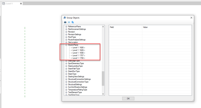

I have an add-in that uses ElementTransformUtils.MoveElement quite often. Recently I've encountered certain elements that i'm unable to move do to work plane restrictions.
Is there a way to emulate the user selecting "Disjoin" in UI when moving elements using the API?
For example, I have instance of a Face Based Generic Model family who's current work plane is "<not associated>". Using the Revit UI, I can move the object in any direction if I select "Disjoin". If I do not select "Disjoin" then the move is restricted to the direction of the original work plane family was associated with but no longer exists. This same restrcition exists when moving the object using API, and I'm unable to find a way to emulate selecting "Disjoin" during the API call.

  1. I started a blank project and added a reference plane. This first screenshot illustrates that NO sketch plane is created by simply adding a reference plane.

  1. Now, using the API, if I try to move the family instance using ElementTransformUtils.MoveElement, it will only move in a direction that remains in line with the “host” sketch plane.
    1. Note: I did find that if I were able to determine the sketch plane element via API that I would be able to move the family instance and the sketch plane essentially eliminating need to “disjoin” the two. However as stated above I cannot find a way to determine this relationship via API. This can be manually demonstrated by selecting the sketch plane by ID, then also selecting the family instance, and manually moving. Doing so allows user to move family instance without selecting disjoin.
To conclude, my main problem is that I cannot use the API to determine the associated sketch plane of a “not associated” face-based family instance. If I could determine the sketch plane then problem solved.
