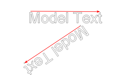

Hi everybody,
How to get direction of model text(text 3D, not textnote) in Revit api?
Please see the image below to understand more about my question?

The case I want to mention is that the text model is not the text note.
Moustafa_K
Model text, in fact, is a bit tricky to determine its rotation value. I attempted to inspect its solids in the hope of finding any reference lines to grasp it, but I was unsuccessful. As I expanded my investigation to comprehend how model text functions, I discovered some hidden references. These references are visible on the user interface only when you attempt to align the model text or draw a line over it.
Which I couldn’t figure out how to identify these references. But wait, here comes the tricky part. When I attempted to obtain the geometry of this model text element, I got 2 solids. The first one has faces and edges, and the second one has zero faces and edges. I thought the second empty solid was indeed empty, but it turned out not to be. When I applied SolidUtil.SplitVolume to the empty solid, it produced 8 solids with actual volumes [ @jeremy_tammik , might be a bug? ].
Continuing with this account, the 8 returned solids are single-faced solids. These faces represent the references that I managed to select while hovering the mouse over. Through experimentation, I realized that the first solid returned always indicates the direction of the text.
Now the rest is just a couple of lines code to get the angle.

 hope this helps
