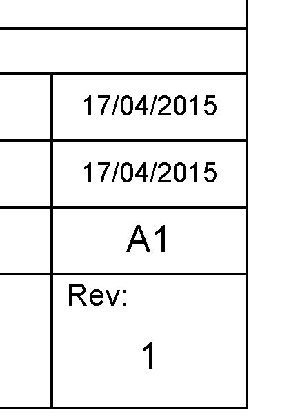

Hi all,
Really i am strugling for changing the dates in each sheets is there any options/programe for changing the dates certain printing set sheets/view groups.
Thanks & Regards
Vinay Krishna
