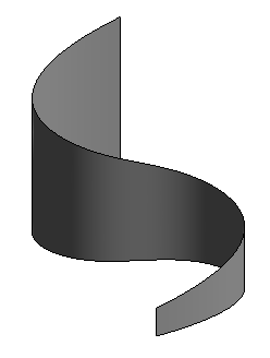

You can use the following code to create non-planar curves and loft:
  // Create an S shape with control points and weights
  List<CurveLoop> cls = new List<CurveLoop>();
  IList<XYZ> bottomControlPoints = new List<XYZ> { new XYZ(100, 100, 0), new XYZ(50, 100, 0), new XYZ(50, 50, 0),
      new XYZ(100, 50, 0), new XYZ(100, 0, 0), new XYZ(50, 0, 0) };
  IList<double> weights = new List<double> { 1, 1, 1, 1, 1, 1 };
  Curve bottomCurve = NurbSpline.CreateCurve(bottomControlPoints, weights);
  // Z coordinate is varied for the top curve
  IList<XYZ> topControlPoints = new List<XYZ> { new XYZ(100, 100, 10), new XYZ(50, 100, 20), new XYZ(50, 50, 30),
      new XYZ(100, 50, 40), new XYZ(100, 0, 50), new XYZ(50, 0, 60) };
  Curve topCurve = NurbSpline.CreateCurve(topControlPoints, weights);
  CurveLoop bottomLoop = new CurveLoop();
  CurveLoop topLoop = new CurveLoop();
  bottomLoop.Append(bottomCurve);
  topLoop.Append(topCurve);
  cls.Add(bottomLoop);
  cls.Add(topLoop);
  SolidOptions options = new SolidOptions(ElementId.InvalidElementId, ElementId.InvalidElementId);
  Solid mySolid = GeometryCreationUtilities.CreateLoftGeometry(cls, options);
  Assert.IsNotNull(mySolid);
Here is a DirectShape generated from the resulting solid:
I hope this answers many of your questions.

Message 7 of 14
Thank you very much for the reply.
As promised it works as expected except a tiny but important aspect. If I create the surface via a DirectShape I cannot edit it after the creating and this is something I would like to do.
Is there any other method to achieve this?
Best,
Miguel

thanks I got the answer from the following link:
https://knowledge.autodesk.com/search-result/caas/CloudHelp/cloudhelp/2016/ENU/Revit-API/files/GUID-...
You just have to package the solid in a GeometryObject Array, then DirectShape.CreateElement works.
Regards, Dirk
