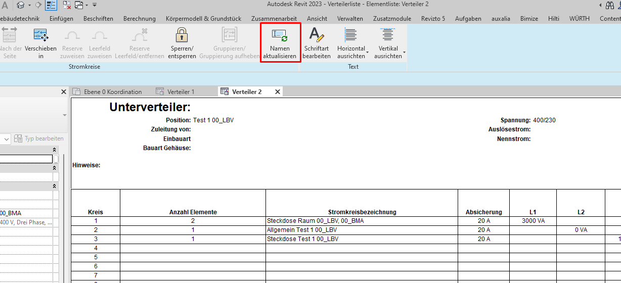

How can I use API to control whether names need to be updated in a distribution list?

Erich.Kallenda
This is a Parameter in the Panel Shedules, and changes you must make manually.
When in project are 50 panel shedules it ist many time you need to control.
Erich.Kallenda
When you have changes, you mast go into the list, and take the button "Update Names"

I am Erich's colleague and have asked him to improve the program's weakness. In the Revit distribution lists, there is only one way to change the elements or the description of the circuit. The 'Circuit Description' is automatically generated from the parameters of the circuit [Load Classification] and [Space Name-Number].
When I move the element to another room, Revit does not update it automatically - you have to manually click into the cell first, and then the 'Update Name' button becomes available, which you can click. (Gelöst: Electrical Circuits - Update Names - Autodesk Community)
We want to achieve with the programming that the user is first shown the list of changed distributors (i.e., elements that have been moved to another room), and the user can then decide which distributor to update. Erich has started to create a logic and is first looking for this function in the API.
Could you please show us the direction again based on the new findings?
