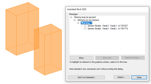

There are 2 ways to find an answer to your problem, not involving a transaction or regeneration.
The first works in conjunction with the InstanceVoidCutUtils.InstanceVoidCutExists(topPlate, verticalStud) method. Use the document warnings to find elements that are cut/joined but don't intersect. You'd have to determine which warning is valid for the studs/plates, as there are several warnings that give information regarding a disjoined state.Warning_NotIntersecting.PNG

The second solution is to use the Element.GetGeneratingElementIds(face) method on all the faces of the plates, and find if the Id of the stud is contained in that list, meaning the stud is intersecting the plate.
Return ValueThe id(s) of the element(s) that generated (or may have generated) the given geometry object. Empty if no generating elements are found. If the set contains just one id, it is the id of the element that generated the geometry object.

maxime.touchard7RAK6
Hi guys,
Thanks for all your help.
For the record here is the solution i'm using :
InstanceVoidCutUtils.GetCuttingVoidInstances(bottomPlate).Any(i => i.IntegerValue == verticalStud.Id.IntegerValue)
