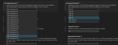

Thanks for helping, I did what you've said but still I dont see that 4.8 option in my project, or when trying to set up a new project... I also tried resetting my PC and VS.

Looks like is not possible to change .NET Core to .NET Framework using the Application properties, but you can change directly if you edit the .csproj.
When creation a new project you need to select the .NET Framework version.
Manually editing the .csproj to change TargetFramework is the only way if you want to use the same project.
In Visual Studio you can double click in the name of the project and the .csproj open when your project was created with .NET Core template, or right click and Edit Project File.

My script is running and working thanks to you.
The weird thing is, is that when I did Autodesk's add-in tutorial - I did it with the .net 8.0, and It worked properly.
In my original project I even changed the C# syntax to match the 4.8 version, But what made it finally work is creating a new project with the 'Class Library' you suggested.
