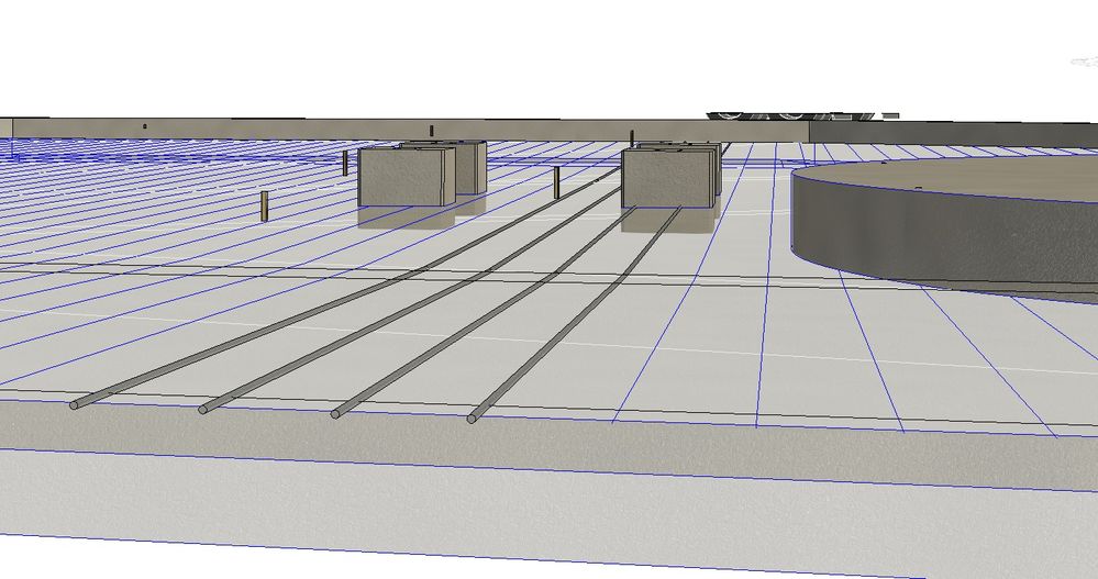

Just pulled the code for direct shape before your post,  it will be an option, but I may just go with the family so I can control the rebar as a group and assign materials etc.
For now I just drew model lines on each face of the compound floor and using routines to collect the lines into individual loops in a curve array array, then will sweep each curve array with the profile of the rebar number.
Eventually will have the user pick the floor and then the direction of the rebar, then the rebar number,  then the spacing, then the cover offset for sides and top, and will generate the linework over the floor via the api (cropping the ends by the side cover, then move the whole system down by the top cover amount at the end.
The autodesk response for this functionality was that is was too complex for now,  dunno,  I'm not a programmer by trade or education, but I will have it in a day or so.

User can now select a floor, pick the faces to generate rebar for,  pick an edge to set rebar direction, input the rebar #,  input the rebar spacing, and set the rebar cover distance down from the top of concrete.
Result:
