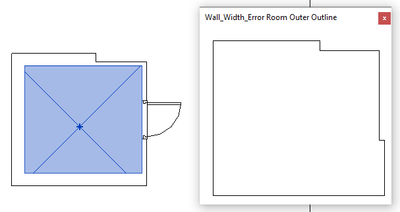

I hope someone can help.
I have raised a previous post regarding Generating Views from rooms but feel that has probably run its course.
The problem I now face is how to follow the outer face of the wall were the wall changes thickness over its length and when room separators are utilised.
When the walls step back like image 1 there is an error “Curve loop couldn't be properly trimmed”.
Regarding room separators, the problems occur when the separator is as image 2, Error “Curve loop couldn't be properly trimmed”.
Situations like Images 3 there has been no errors so far!
I am working in c# with Revit 2020 and utilising the following to create the offset:
CreateViaOffset(CurveLoop original,IList<double> offsetDists,XYZ normal)
IList<double> is the thickness of the surrounding walls and a standard set offset for the room separator.
Is this a problem with the API or is there a solution to my problem that I am missing.

OK, well, I have not solved it yet, but at least uncovered one definite problem.
In the room separator model, the curve loop that you assemble has 11 elements, whereas the wall thickness list only has 10. That obviously causes a problem.
I implemented a new method CreateModelCurves that creates a set of model curves to display the curve loop. The result for the room separator model looks like this:
Room separator model curve loopRoom separator model curve loop
The new code is in the repository:
https://github.com/jeremytammik/CropViewToRoom
Please do not copy it out as a zip file.
Instead, clone the repo to your local file system, apply whatever changes you make, and submit a pull request for me to integrate them back into the repo. That will save unnecessary copying back and forth and manual integration on my side. It also adds useful information tracking of your commits to see what you change and why.
I leave it up to you to figure out where that extra segment is coming from, what it represents, and how to deal with the wall thickness for that one.
Maybe that will help sort out the other issue as well.
I reproduced the exception you mentioned creating the offset loop for the wall thickness model.
I'll ask the development team for a usage example of the method to see what we might be doing wrong.

I see several possible approaches, based on:
  • Room boundary curves and wall thicknesses
  • Room boundary curves and wall bottom face edges
  • Projection of 3D union of room and wall solids
  • 2D union of room and wall footprints
The most immediate and pure Revit API approach would be to get the curves representing the room boundaries, determine the wall thicknesses, offset the wall boundary curves outwards by wall thickness plus minimum offset, and ensure that everything is well connected by adding small connecting segments in the gaps where the offset jumps.
Several slightly more complex pure Revit API approaches could be designed by using the wall solids instead of just offsetting the room boundary curves based on the wall thickness. For instance, we could query the wall bottom face for its edges, determine and patch together all the bits of edge segments required to go around the outside of the wall instead of the inside.
Slightly more complex still, and still pure Revit API: determine the room closed shell solid, unite it with all the wall solids, and make use of the extrusion analyser to project this union vertically onto the XY plane and grab its outside edge.
Finally, making use of a minimalistic yet powerful 2D Boolean operation library, perform the projection onto the XY plane first, and unite the room footprint with all its surrounding wall footprints in 2D instead.
The two latter approaches are both implemented in my ElementOutline add-in:
https://github.com/jeremytammik/ElementOutline
I mentioned it here in two previous threads:
Probably all the pure Revit API approaches will run into various problematic exceptions cases, whereas the 2D Booleans seem very fast, reliable and robust and may well be able to handle all the exceptional cases that can possibly occur, so I would recommend trying that out first.
I hope this makes for a nice gift to you in this festive season.

Well, I seem to have beaten you to it after all:
https://github.com/jeremytammik/ElementOutline/releases/tag/2020.0.1.2
I make use of the 2D Boolean Clipper library.
It successfully handles the wall width sample model:
It also gracefully handles the room separator situation:
Happy New Year!

I have finally had a few moments to try out the solution and all appears to work well, with one exception. The instant doors windows etc are introduced the outline is not as expected.Outline Door Error.pngOutline Window Error2.png
Havent had a chance to explore reasons why and possible solution.
I was expected the introduction of the door or window to included a projection in the same way as the handle on the desk example https://thebuildingcoder.typepad.com/blog/2020/01/extrusion-analyser-and-2d-boolean-element-outline....  however it does appear to do something altogether differant?
Regards

I have started to examine the code in relation to first integrating into CropViewToRoom to implement the complete job.
If I understand the code correctly the line
JtLoops loops = Cmd2dBoolean.GetRoomOuterBoundaryLoops(room, seb_opt, view );
loops is the outer loop however I regret I cannot see how this links into
CurveLoop cloop = CurveLoop.CreateViaOffset(loops, offset, normal );
As this returns an error.
I assume JtLoops loops needs converting somehow into a CurveLoop?
Regards
Stephen
Message 20 of 28
jeremytammik
Yes, indeed, of course. It is pretty simple. Furthermore, the JtLoop data is in millimetres, and the Revit database stores all lengths in imperial feet, so you will have to multiply the data by 25.4 (to convert mm to inch) times 12 (to convert inch to foot). Or divide by those values, or something.
Jeremy Tammik
