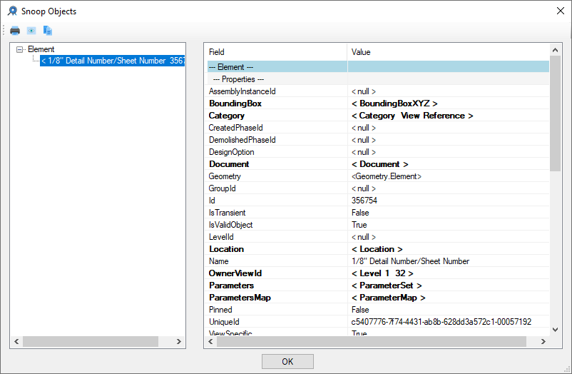

I want to change ViewReference's refernce view, I have found one method "ReferenceableViewUtils.ChangeReferencedView" but its only working for section or callouts and not ViewReference.
Is there any way to do this for this type of element?

Hi @sahin.ikbal,
I've checked an instance of reference view via Revit lookup add-in,
I found that the reference view element's meta data is drafted in a built in Revit parameters and not a C# class props!
I didn't try to update the parameter value, may you give it a try ?
I hope it will work,
Regards,
sahin.ikbal
That's a Read-only parameter.
I have tried.
