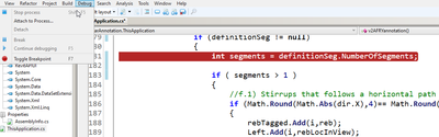

Hi Thomas, appreciate the time you put into this topic. By the way, I could not even use the step by step debug, Do I need to change the shardevelop settings to see that command?
Message 10 of 13
AGGilliam
After placing your breakpoint, make sure Revit is running and select Attach to Process, then select Revit. After you've attached to Revit you can run your command and start debugging. Although, you'll need to have the latest build of your code in your addins folder in order for it to work correctly.
Message 11 of 13
RPTHOMAS108
When you press the 'Edit' button the below controls are not visible, so use 'Edit', place your breakpoint, keep the editor open in the background, go back to the Macro Manager window, then press 'Step Into'.
Message 12 of 13
AGGilliam
My apologies, just realized you mentioned the macro manager. My previous comment was for addins. I never use macros so I kind of forgot they existed.
