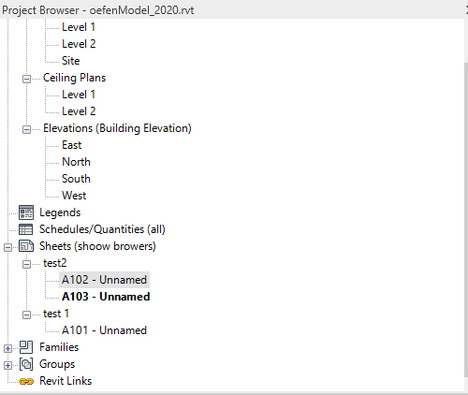

I am new and still learning the Revit API & C#. I want to change the sheet issue date to the current date. I know how to do this for all the sheets, but now I want to do it for only a couple of sheets. For example only for the sheets that are under the "test2" how can i do this with C#?

RPTHOMAS108
You will have to look at the browser organisation to understand what parameter 'test2' is a value of. This will be one of the parameters associated with the sheets.
Via the API you have limited access to browser organisation
BrowserOrganization.GetCurrentBrowserOrganizationForSheets
The property BrowserOrganization.SortingParameterId may be of interest but in reality the project browser has many levels of sorting/grouping so it doesn't seem current API object fully encompasses that.
There is also BrowserOrganization.GetFolderItems but you have to supply the View.Id of a view within such a folder. Then each such item has properties ElementId  (the folder parameter id) and Name (the folder name).
If you are working with a known browser organisation with the same company template then you can establish the above by investigating in the UI.
Regardless 'test2' will likely be a value of a parameter on a sheet.
This is another intriguing example of StorageType.None i.e. BrowserOrganisation object contains parameters named Filter and Folders (not accessible to API).

Thinking further about this you can filter a set of sheets via LINQ similar to below:

Thank you so much for the comprehensive answer, it really helped. I am only having some trouble converting the code into C# especially this line:
"Dim Els As List(Of ElementId) = FEC.WherePasses(ECF).ToElementIds _
.Where(Function(k) bOrg.GetFolderItems(k)(1).Name = "Type 1") _
.ToList"
Do you know how to rewrite this in C#?

Here is a solution that does away with the FEC and ECF variables:
  string t = "Type 1";
  BrowserOrganization bOrg = BrowserOrganization
    .GetCurrentBrowserOrganizationForSheets( doc );
  IEnumerable<ElementId> ids
    = new FilteredElementCollector( doc )
      .OfClass( typeof( ViewSheet ) )
      .Where( s => bOrg.GetFolderItems( s.Id ).First().Name.Equals( t ) )
      .Select<Element, ElementId>( e => e.Id );
It also eliminates the unnecessary and slightly performance- and memory-consuming calls to the ToElements and ToList  methods. Makes no difference in this case, I guess, except less strain on human reader's eyes 🙂

Joost____
I used your code and it worked! Thank you very much. With this code I can update the date of a group of sheets. The next step for me to figure out is how to create a drop-down menu with all the sheet group names. This way the user can easily select which set of sheets need to be updated.
