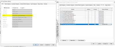

I am trying to automate changing the phase of a Revit Link inside of a View Template.
Here is what happens when I create a new view using the Revit user interface. This same issue happens when I use the Revit API to automatically create the views in a project setup script.
- The new view from my model shows the New Construction phase (pic 1).
- However, the architectural model Revit Link has it set to a different phase, even when it is marked as "By Host View" (pic 2).
This means I have to change all my view templates to "Custom" for each Revit Link and manually set the right phase for each.
I have been able to use the following code to successfully change the Phase Filter in the Revit Link Display Setting, but have not been able to change the Phase. It seems this may not be exposed in the Revit API.
Are there any ideas why this may not be working?

Doing further investigation, having Revit Links checked or unchecked in the View Template makes a difference. If Revit Links is checked in the View Template, it always has the Linked Model go to the most recent phase when creating a new view. The behavior below happens when creating a view through the user interface or through the API.
Is anyone else not seeing this behavior?
Pic 1: Phase Mapping
Pic 2: Our model view phase
Pic 3: Linked Model view phase if Revit Links is unchecked in the view template
Pic 4: Linked Model view phase if Revit Links is checked
