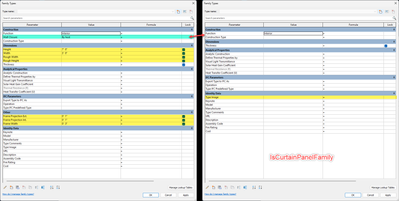

Upon reading this again, I think my previous answer did not correctly interpret what the OP was asking. From what I can tell, your best bet will likely be to access the "Host" parameter (BuiltInParameter.FAMILY_HOSTING_BEHAVIOR):
door.Symbol.Family.Parameters("Host").AsValueString()
This string should be empty for door families based on curtain panel template, and will be "Wall" for other standard door types. Have not tested this extensively, but so far it looks like it works well as an a priori filter for any family.

If you were hell-bent on not using, IsCurtainPanelFamily Property, with parameters, you may be able to determine it with the following:
 Parameter wallClosureParam = door.LookupParameter("Wall Closure");
get_Parameter(BuiltInParameter) ; enum TYPE_WALL_CLOSURE
get_Parameter(BuiltInParameter) ; enum DATUM_PLANE_DEFINES_WALL_CLOSURE
Left is Door, Right is Curtain Door Family template .rtf.
Maybe....?
Message 18 of 18
sensiblehira
Revit lookup is giving the value as false for all curtain panel families. It would have been helpful if the value was assigned to it.
