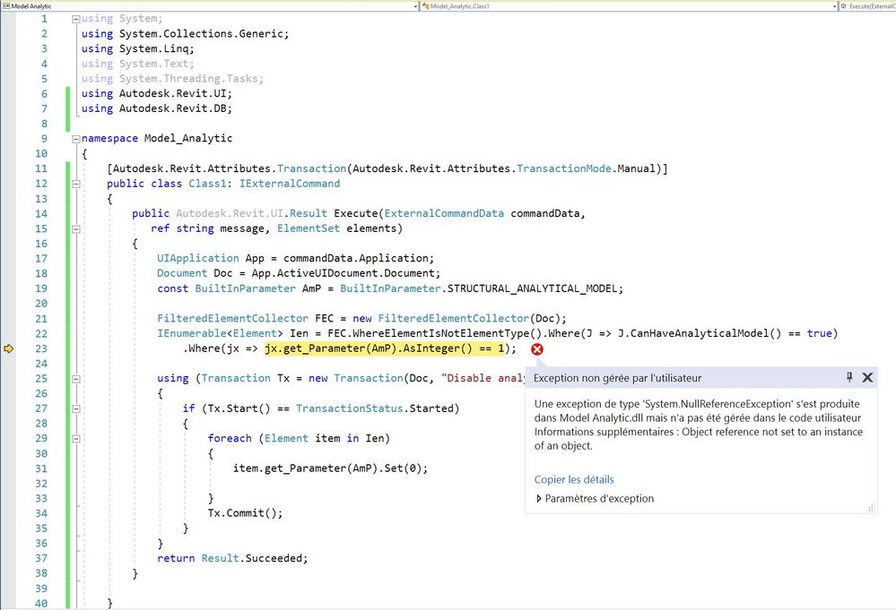

hvdsidf
Dear All,
I run your code but there is an error as below:
And in Revit, it shows this message:
Please help me, I'm a beginner with Revit API.
Thanks alot for your help  and Best Regards,
