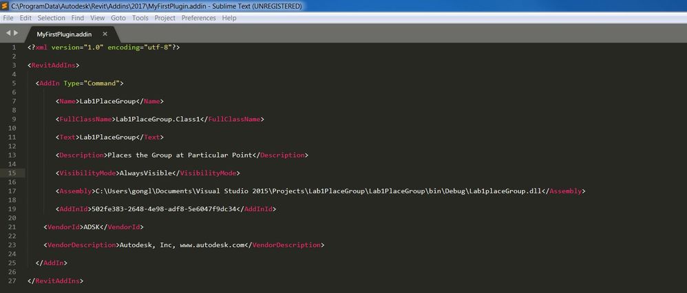

Hi Mustafa,
Thanks for the reply. I checked the .addin file and did not find problems. Please see the screenshot below. The yellow debugging arrow is still not showing up. I think it is more about how to set up configurations to attach visual studio debugging session to the Revit session. We can have a goto meeting if you like. Can you please suggest? Appreciate it.
.addin file.addin file

Message 16 of 20
Mustafa is so helpful during the goto meeting and found the issue in the manifest file. On Line 19 below, we changed 34 to any random 2 digits (0-9, a-f). The original AddInId was conflicting with an existing .addin file. After changing 34 to 66, the debugging yellow arrow pops up.
Mustafa is a magician! Cheers!
