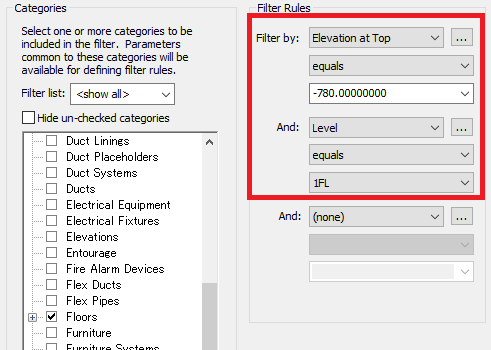

Hello, I am a beginner of REVIT API.
Recently I have been writing a code that applies the filter rules in a short time.
Works well if only one filter rule is applied, such as the first capture.
However, the code for implementing a second capture, for example, does not work.
If a user-defined level exists, the user has created a code to add filter rules for it.
Is there a problem with my code?
thank you.

 private ParameterFilterElement Pvt_CreateFloorLevelFilter( Document doc, string filterName, double value )
      ParameterFilterElement filter = null;
      ICollection<ElementId> categories = new List<ElementId>();
      categories.Add( new ElementId( BuiltInCategory.OST_Floors ) );
      // Level Offset Value Paramter
      ElementId param1 = new ElementId( BuiltInParameter.FLOOR_HEIGHTABOVELEVEL_PARAM );
      // Level Parameter
      ElementId param2 = new ElementId( BuiltInParameter.LEVEL_PARAM );
      // Level of user select
      Level targetLevel = _form.Transfer_SelectedLevel();
      var miliValue = UnitControl.Millimeters_To_Feet( value );
      IList<FilterRule> rules = new List<FilterRule>();
      // Set rule Level Offset
      FilterRule rule1 = ParameterFilterRuleFactory.CreateEqualsRule( param1, miliValue, Double_Epsilon );
      rules.Add( rule1 );
      // If there's user selected Level, add it
      if ( targetLevel != null )
        FilterRule rule2 = ParameterFilterRuleFactory.CreateEqualsRule( param2, targetLevel.Id );
        rules.Add( rule2 );
        filter = ParameterFilterElement.Create( doc, filterName, categories, rules );
        return filter;
      // If there's no user selected Level, apply only this rule
      else
        return filter;

It was solved by using "SCHEDULE_LEVEL_PARAM" instead of "LEVEL_PARAM".
