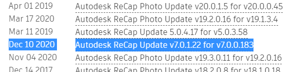

klarinda.gunadi.widjanarko
Btw we normally post the service packs to the following page:
https://knowledge.autodesk.com/support/recap/downloads
But it's not sorted based on date, so you may need to click "See More" and scroll down.
Thanks.
Klarinda Gunadi Widjanarko
Senior Software Engineer
