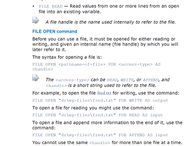

lokesh.kalia
@old_snickers Hi. You don't actually need the double quotes around inp, given that this is a single word without spaces.
See the extract from the Macro Programming Guide below, which shows an example of defining so-called file handles without any quotes:
You can find the latest version of the Macro Programming Guide here: https://www.autodesk.com/support/technical/article/caas/tsarticles/ts/26zXUqtRe1Tur1KdK1pctn.html
(scroll down towards the bottom of the page).

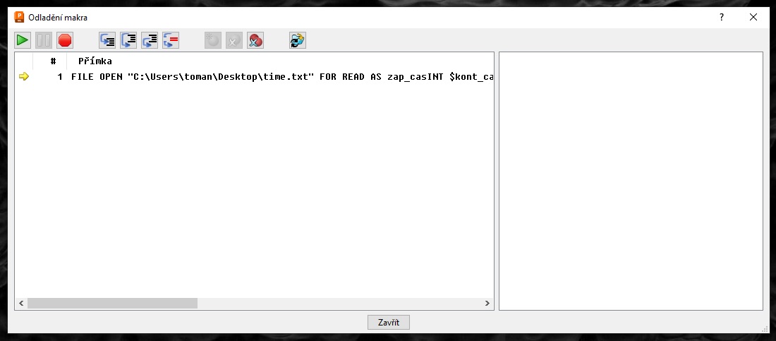

@tomanT9U6N Hi. Unfortunately, I also can't reproduce your error. You might try using the 'macro debugger', it might give a clue to what is going wrong.
You invoke this by:
macro debug <path-to-macro-file>
I hope that will help.

tomanT9U6N
When I try macro debug, the whole code is displayed in one line. That's weird.

kevin.hammond3WX4X
1 last thing based on your last response.
what text editor are you using, i am wondering whether when you hit enter to go to the next line whether you are getting a carriage return line feed command?
I use notedpad++ but windows text editor will do, i would not use wordpad as it can give spurious results.
I have switched on these characters using..View...Show symbols
If you do not have these characters it would cause the whole macro to appear on one line
Message 14 of 14
tomanT9U6N
You are an absolute legend! I had the line ordering set to CR. After switching to CRLF the macro works!
