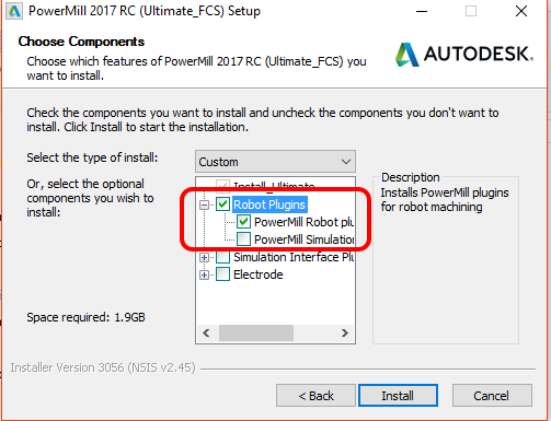

If you are subscriper of PowerMill Premium Version you could use PowerMill Robot Plugin (Needs to be activated during Installation).
With PM Robot you can adapt the post processor to what you need (Robot type, Robot Language, user specific customisation).

What version of PowerMill do you have?
If you have Ultimate or Premium versions  you have PowerMill Robot included.
Standard does not.
please refer to this link for further info  http://www.autodesk.com/products/powermill/compare-products
You need to select the component to install during the install process.
