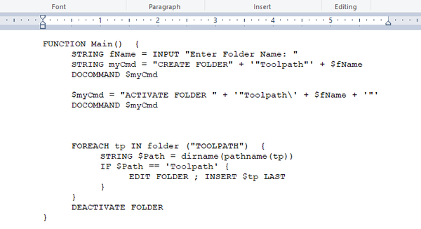

Hey, sorry, I'd left for the day.
I'm sure I did copy everything. Deleted it all and copied again. This is what I've got.
Closed my session, reopened, and tried again. I got the same result.
Running it out of the "Choose"  button. it gets as far as naming the folder, but doesn't create it.
Holds up here again on line 4?
I did try running it again through the macro list.
Same result.
I'm running 2023 Ultimate without the updates. Don't think that matters though, the macro should run on much older versions too.

Message 8 of 19
TK.421
huh... i'm at a loss! I retyped the whole thing and ran it again & i have success. run it through the macro debugger step by step and see what you get

Message 12 of 19
TK.421
ah-HA! it does not like the space in the folder name. put an underscore or hyphen or camel case (drillingBottom) and you'll be golden
the numbers never lie
Message 13 of 19
Beta_Librae
OH YAA!!
That's funny. Silly thing.
Thanks again for your help. Greatly appreciated!
