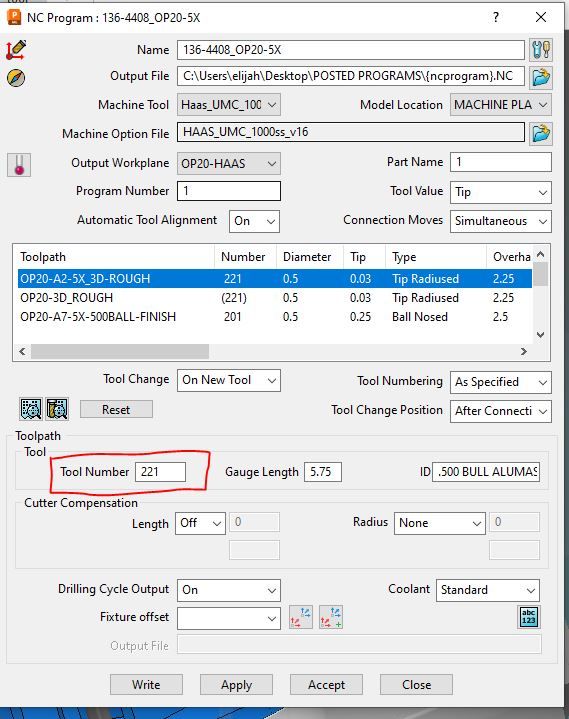

Hey all, so I was wondering if there is a way to write a macro to change tool numbers in an NC Program. The reason I ask is because; all of our 3-axis machines allow up to like 500 tools in the offset page whereas our 5-axis machines only allow up to like 200 (Haas). So, when programming and a job starts in 3-axis and ends in 5-axis, when I go to post out a 5-axis program I have to go into the NC program and manually change all the tool numbers, so we don't get an alarm on the machine. I would rather not have multiple tool libraries or multiple entries in the tool library to accommodate for this. Is there a way to write a macro that would change these tool numbers in the NC Program for me when I'm ready to post? I'm aware i would have to build the list in its entirety into the macro but that's fine. I'm just very unsure of how to phrase all the if-then statements (If that's what I would even use)

here is an example of a 3-axis program
5-axis program before settings change
this is where i change my tool numbers in the nc program
and this is what it looks like after the change, the asterisk notes that a change was made.

this is what i had in mind for sure. Is this going to change the tool numbers in the project though or just in the nc program? see my pictures above

but please make a backup of your project first i did not tested it jet...

E-Singer89
it works!!!! thank you!!!!
