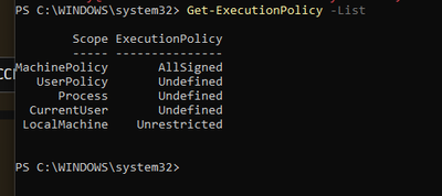

Message 27 of 42
rafael.sansao
It shouldn't.
Type: Get-ExecutionPolicy -List
And show me the image
Rafael Sansão
OptiNC - www.optinc.tech
Message 28 of 42
iamcdn79
Intel Core i9 13900KF CPU
128 GB Kingston Beast DDR4 SDRAM
PNY RTX A2000 6GB Video Card
WD 1 TB SSD Hard Drive
Windows 11 Pro
Message 29 of 42
rafael.sansao
The error you're receiving indicates that the execution policy was successfully updated, but it's being overridden by a policy defined at a more specific scope. This means a policy set at a higher level (such as in Group Policy or at the `LocalMachine` level) is taking precedence.

iamcdn79
does it maybe mean for this when right-clicking "Turn on Script Execution"?
Windows 11 Pro
Message 32 of 42
rafael.sansao
Apparently so. You have to try it!
Rafael Sansão
Message 33 of 42
iamcdn79
That was the problem, changing it to "allow all scripts" from "allow only signed scripts" macro code works now.

			FILE WRITE $ps1_content TO cmd
			FILE CLOSE cmd
			OLE FILEACTION 'open' $ps1_path
			STRING $cmd_content = "@echo off" + CRLF + 'powershell -ExecutionPolicy Bypass -File "' + $ps1_path + '"'
			STRING $cmd_path = "C:\temp\run.cmd"
			FILE OPEN $cmd_path FOR WRITE AS cmd
			FILE WRITE $cmd_content TO cmd
			FILE CLOSE cmd
			OLE FILEACTION 'open' $cmd_path
			WAIT 2
			DELETE FILE $cmd_path
			DELETE FILE $ps1_path

Message 39 of 42
artur.boszczyk
why cannot you just simply pack this command
"C:\Program Files (x86)\Microsoft Office\root\Office16\WINWORD.EXE" /t "C:\AWB\3732-2008A_wingpin_v2.html"
into .bat file and execute it using
OLE FILEACTION 'open' "C:\AWB\open.bat"
Message 40 of 42
iamcdn79
That had no effect.
I got it to work using VB Script now
