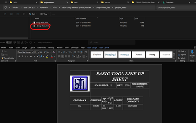

I think the directory code is incorrect. The macro code is looking into 'C:/Powermill/1792/1792 cavity/SetupSheets_files/project_sheets/lineup sheet.html' directory which doesn't exist for the lineup sheet.html file
The correct directory should be 'C:/Powermill/1792/1792 cavity/SetupSheets_files/project_sheets' to open the file called lineup sheet.html
When I change it to this code it opens a new file explorer window of that directory showing the lineup sheet.html file but doesn't open that file

Same error as before because I think its looking in the wrong dir.
The correct dir should be 'C:\Powermill\1792\1792 cavity\SetupSheets_files\project_sheets' but the error code is showing dir called 'C:\Powermill\1792\1792
cavity\SetupSheets_files\project_sheets\lineup sheet.html' which doesn't exist
This is the dir it should be pointing too for the file called lineup sheet.html

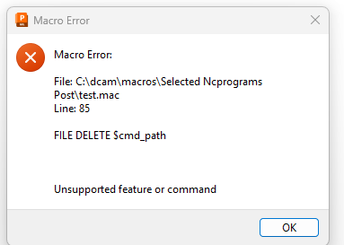

iamcdn79
Yes! that opens, but i get an error on line
FILE DELETE $cmd_path​
after the file opens.
Is it trying to delete the lineup sheet.html file or that directory that it exists?
Removing that line seems to run without issues.

rafael.sansao
FUNCTION Main (STRING $Selected_NCProgram)
    // Execute preliminary commands
    KEEP SETUPSHEETS NCPROGRAM SELECTED
    TEXTINFO ACCEPT
    SPLITTER TABEXPLORE
    // Get the main project directory and construct the exact path
    STRING $mainDirectory = REPLACE(project_pathname(0), "/", "\")
    STRING $htmlFilePath = $mainDirectory + "\SetupSheets_files\project_sheets\lineup sheet.html"
    IF NOT file_exists($htmlFilePath) {
		MESSAGE WARN "File not exists"
		MACRO ABORT
	} ELSE {
		STRING $cmd_content = "@echo off" + CRLF + 'start "" "' + $htmlFilePath + '"'
		STRING $cmd_path = $mainDirectory + "\run.cmd"
		FILE OPEN $cmd_path FOR WRITE AS cmd
		FILE WRITE $cmd_content TO cmd
		FILE CLOSE cmd
		OLE FILEACTION 'open' $cmd_path
		WAIT 1
		DELETE FILE $cmd_path
Rafael Sansão

I think it could because when I always close it manually its asking me if it needs to be saved or not due to a macro I have which runs and changes values automatically everytime it opens that particular file.
Is there a way to add a no to not to save the file then close it?

iamcdn79
No go.
Would a lockfile be preventing it from closing? When I have the file open there is a hidden file in the dir called "~$nep sheet.html"
