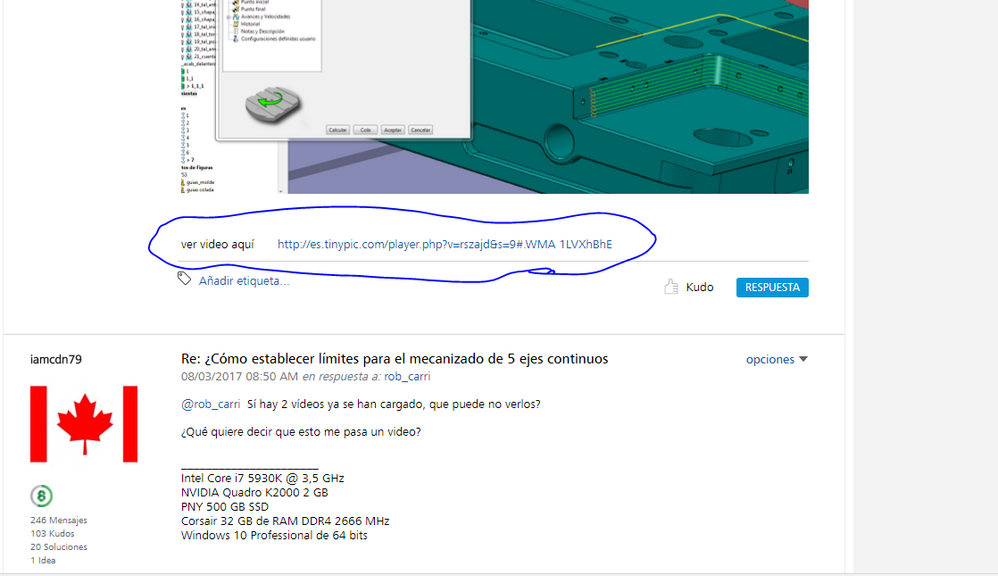

How have you uploaded the video? And I passed you a video

see video here       http://es.tinypic.com/player.php?v=rszajd&s=9#.WMA1LVXhBhE

iamcdn79
@rob_carri Yes there are 2 videos uploaded already, can you not see them?
What do you mean you passed me a video?

rob_carri
@iamcdn79
Sabia CÓMO subir vídeos, busqué Un sitio web Donde párrafo Acoger uno
Lee Mi Mensaje anterior to see Si Es La Solución Que busca

Yes I clicked on the link but there aren't any powermill videos shown

rob_carri
Put this address in the explorer bar       http://es.tinypic.com/player.php?v=rszajd&s=9#.WMA8BFXhBhG
You have the pattern very down.
If you want to leave the pattern down you have to choose towards the curve
But towards the curve is not the correct solution, because the tip of the tool will look towards it and do not lower the path giving you collision.
Create the pattern above ....
Wait i do it to you
