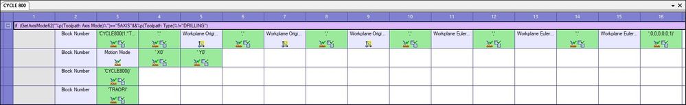

I'm Having problem with cycle800 code for siemens control on DMG dmu65_Monoblock 5-axis machine.
I got help from a gentleman @Carlos.PintoLRW5G, last time  who helped me regarding 3+2 concern with cycle800. A big thanks to him...
But now I'm dealing with 5-axis movement for cycle800.
I'll be thankful to who contribute his help.
I have attached an image for more clearification.
I need these prameters ....... down below
Thanks to all in advance.

Hi @karan30782 , here is what I'm using in our machine.

Thanks for your help. I have modified the post file as your suggestion.
Will let you know once it run on machine.
Thank again !
karan30782
Hey, @Carlos.PintoLRW5G
Thank again, you are the saviour.
I used the supplied parameters and it worked as expected.
Cheers !

Just another question. I'm stuck at a point.
What should I keep for N-Block 59 ?
e.g. Machine B/C, Workplane Euler B/C , or somthing else you suggest.
Thanks & Regards.
Carlos.PintoLRW5G
Hi @karan30782 , we use the machine's  B/C starting point of the toolpath.

Actually , I was confused because tool was reaching to some other point.
And the reason was machine kinematic  and calibration was not done.
But, your reply also helped me to solve the issue.
