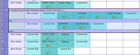

Good morning everyone !!
Thickness problem write !!
If I write like this the post does not write the axial oversize
If I divide the two oversizes the post writes correctly
This post thickness
If I forget to divide the oversizes as in the first case, is there a way to write the oversize in Z?
thanks for your help

Your parameters in PP is correct , but when you create toolpath with collapsed thickness box. It will only show XY thickness value in the nc program,even though you mention different axial value in (axial thickness stock), but as you collapse that box. Only XY thickness show in the nc file. Only with both box expanded will show value in XY and Z thickness in nc file.
And unfortunately there is no solution for this.

 This is what you want.
PCTECNI5
Hy, i have follows your indications but the post generate error.
When i have wrong?
Thank!!

Yes, as you say, it works, but I often forget to open the window.
When I forget, the post doesn't write "Z" overlay, and the operators grumble.

Now write the code but jump the condiction
the condition is missing here in the middle
can you tell me if I was wrong?
