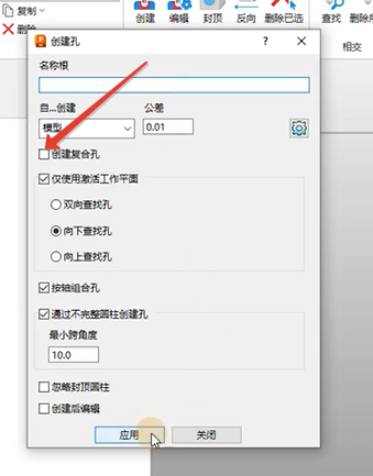

huseyin_sahin
Have you tried creating the holes as a single piece?
Message 14 of 14
570028700
Thank you for pointing out the problem.
EDIT FEATURECREATE HOLES COMPOUND ON.
After being enabled, the macro code works normally.
