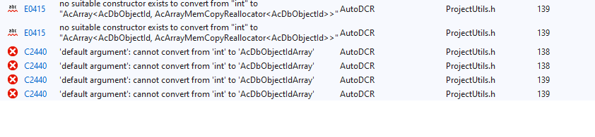

If I assign NULL to AcDbObjectIdArray variable in ObjectARX 2023 in visual studio 2019 it is giving error can not convert from int to AcDbObjectIdArray. Screen shot is attached with this.
Example :
AcDbObjectIdArray arrObj = NULL;
this giving error can not convert from int to AcDbObjectIdArray.
