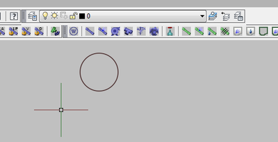

If you are drawing a circular glyph on cursor point, I don't see why a Layer turning off has any affect, I have just tried, I don't see the behavior.
Attached a image for your reference, btw I have tested both
  1. turning  off Layer 0 and while it is being current layer
  2. turning off Layer 0 and while it is not being a current layer.
In both the case, I can't reproduce, can you offset the circular glyph from the input computed point.
output.setNewPoint(input.computedPoint() + AcGeVector3d(0.2,0.2,0.0));
        input.drawContext()->geometry().circle( output.newPoint(), 0.1, AcGeVector3d::kZAxis );
Kyudos
As per your code, I can draw an offset glyph, but it is still controlled by Layer 0.
Layer 0 OffLayer 0 Off       Layer Zero OnLayer Zero On
However, I'm not sure what output is in your code. My output is a AcEdInputPointMonitorResult, and doesn't have the same functions as yours?
