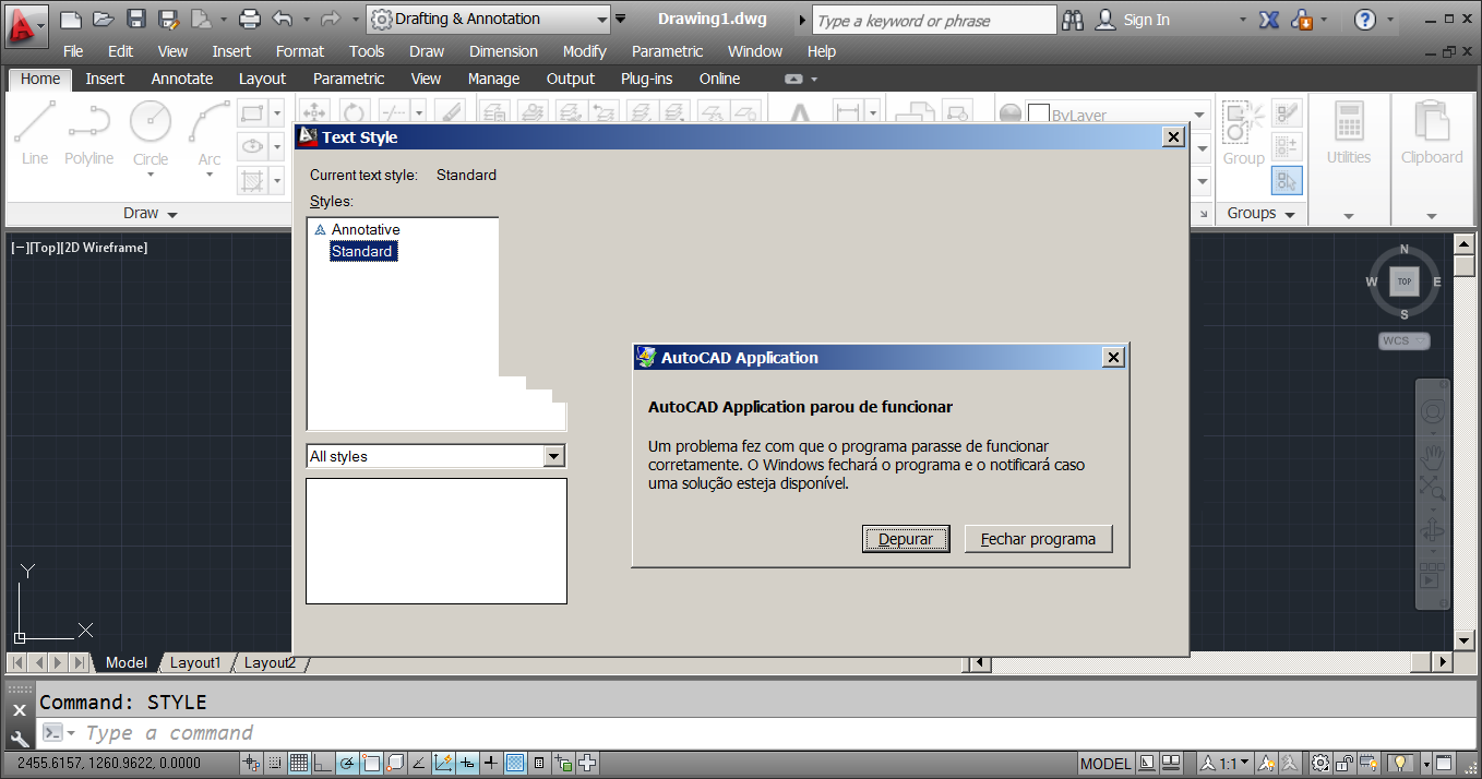

Hello, Varun Gupta.
Just as an addition to tleaxavia's post, this problem is happening with me as well, however, I'm using Windows 7 64-bit pt-BR language, AutoCAD 2013 64-bit english and VS 2013 Professional, also in english.
The steps to reproduce are as simple as tleaxavia mentioned, but I just want to add a few more explanations as to how you can reproduce the bug:
  1. Create a .NET 4.0 C# class library project, setting "Project Properties --> Debug --> Start external program" to your 64-bit executable of AutoCAD 2013/2014 (acad.exe). I confirmed that you do not even need to reference AutoCAD's dlls in this C# project for the bug to be reproduced.
  2. Run your project (F5) so that AutoCAD will load up.
  3. When AutoCAD finishes loading up and opens up the new blank document, just type the "STYLE" command. This command should open a dialog for you to select text styles. (Please note that this is one of autocad's native commands, that is, no custom code will be executed)
  4. As soon as AutoCAD tries to load this text styles dialog, it will crash.
That's it, no custom code required, just the fact that AutoCAD is being debugged with VS 2013 is causing this problem.
I added a few screenshots just to illustrate the steps.
Thank you,
Samir
