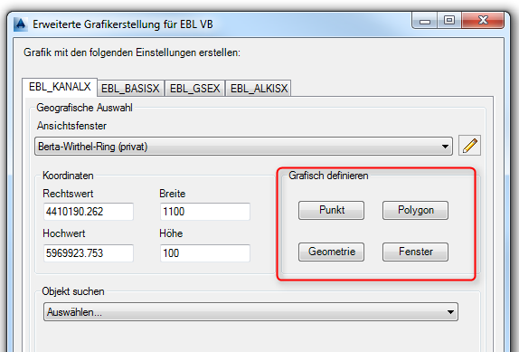

in this code the complete area will draw.
question 1:
is there a way to define a area to draw like the Topobase function in the Dialog?

It's probably best to post Topobase questions in the Map Developer forum.  Use IFilterSetter to apply a geometry filter (c# but hopefully you will get the general idea):
IFilterSetter filterSetter = FilterSetterFactory.Create(gg.DisplayModel);
filterSetter.OnlyOnTopobaseLayers = false;
filterSetter.TransformCoordSysInFilter = true;
var polygon = new Polygon
             new LinePoint(extents2d.MinPoint.X, extents2d.MinPoint.Y),
             new LinePoint(extents2d.MaxPoint.X, extents2d.MinPoint.Y),
             new LinePoint(extents2d.MaxPoint.X, extents2d.MaxPoint.Y),
             new LinePoint(extents2d.MinPoint.X, extents2d.MaxPoint.Y),
filterSetter.ApplyViewport(polygon);
