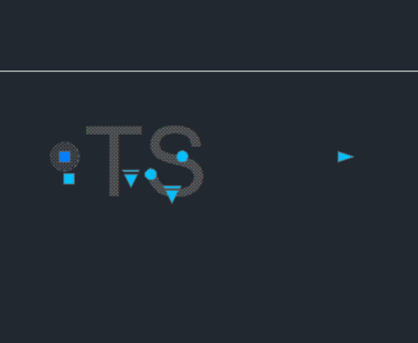

ABOVE BLOCK NEED TO BE REPLACED BY OTHER BLOCK
THE BLOCK GOT PASTE BUT IT IS LOOSING ITS DYNMIC  PROPERTIES I WANT TO RETAIN THOSE DAINAMIC PROPERTIES AFTER REPLACING ALSO.
I TRIED TO REPLACE THOSE BLOCKS BY THE ABOVE BLOCK

You cannot use Clone() to do this. You have to use the DeepCloneObjectsl() method. Alternately, you can use the ActiveX Copy() method.

If you want to create copies of objects, whether they are Dynamic block references or anything else, then you use the API methods that are provided to copy them, which are the ones I mentioned previously.
That is what they are there for, there is no need for you to reinvent those methods.
If you use those APIs, then you do not have to also deal with all of the other potential issues related to copying Dynamic blocks, such as attributes; fields in attributes; and so forth.
See this post for an example use of  DeepCloneObjects.

thankyou for advice after going through your solution i used it in my project now it is  working
