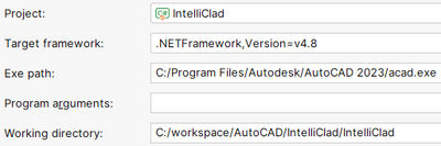

stefanome
I have a run configuration that has acad.exe in the "Exe path". When I run that run configuration, AutoCAD starts and loads the dll. Then I can execute any of my commands and the IDE will stop at any breakpoint. This is how anyone works on AutoCAD addins.
How do I do something similar in a test suite, but where AutoCAD is automatically executed before each test, then the test suite waits for AutoCAD to be ready, then opens a drawing, executes a command and checks the result, then, either after the successful test or the failed test or the AutoCAD crash, it starts again with another AutoCAD session and another test?
