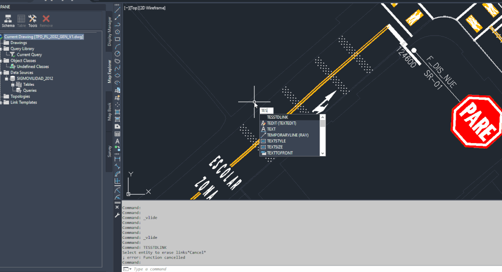

Even without achieving much, I get the error I show, any help you can give me to run these lisp where I can transfer the Link Template to the Object Data, thank you, greetings.
Message 12 of 18
hosneyalaa
HI
You can complete with this code
Code adapted from caotets.lsp
(defun c:TESSTDLink (/ ACADDOC ACADOBJ ADOCONNECT CMD COUNT DBCONNECT ENT1 GADO-DLLPATH GCAOTLB GCMNFILES
		LA_OBJ_IDS LINKTEMPLATE LINKTEMPLATENAME LIST_FIELD_TARGET LSTALLROWS LTGETGETLABELTEMPLATES
		LTGETQUERIES LTS L_FIELD L_OBJ_ID OBJ OB_ID PKEYDESCS PKEYVALUES RS SELECTEDROWINDEX STRCOLUMNNAMES

(defun c:LT_OD (/ dwg ss sdm-dem-demarcacion sdm-dem-inter-demarcacion sdm-dem-clase-demarcacion link-template link-template-field db-file db-table db-field db-clase-field conn rs int-dem clase-dem)
  (setq dwg (vlax-get-acad-object))
  (setq ss (ssget))
  (setq sdm-dem-demarcacion "SDM_DEM_DEMARCACION")
  (setq sdm-dem-inter-demarcacion "INTERNO_DEMARCACION")
  (setq sdm-dem-clase-demarcacion "CLASE_DEMARCACION")
  (setq link-template "SDM_DEM_DEMARCACION")
  (setq link-template-field "INTERNO_DEMARCACION")
  (setq db-file (strcat (getvar 'dwgprefix) "SIGMOVILIDAD_2012.mdb"))
  (setq db-table "DEM_DEMARCACION")
  (setq db-field "INTERNO_DEMARCACION")
  (setq db-clase-field "CLASE_DEMARCACION")
  (setq conn (vl-catch-all-apply 'vla-get-activedocument (list dwg)))
  (setq rs (vl-catch-all-apply 'vlax-create-object (list "ADODB.Recordset")))
  (foreach obj (vl-remove-if-not 'vla-object->ename (mapcar 'vlax-ename->vla-object (ssnamex ss)))
    (if obj
      (progn
        (setq int-dem (vla-putproperty obj link-template link-template-field))
        (vl-catch-all-apply 'vlax-invoke-method rs "Open" (list (strcat "SELECT * FROM " db-table " WHERE " db-field "=" int-dem) conn))
        (if (not (vlax-invoke-method rs "EOF"))
          (progn
            (setq clase-dem (vlax-invoke-method (vlax-get-property rs "Fields") db-clase-field "Value"))
            (vla-putproperty obj sdm-dem-demarcacion sdm-dem-inter-demarcacion int-dem)
            (vla-putcustomstringdata obj sdm-dem-demarcacion sdm-dem-clase-demarcacion clase-dem)
        (vlax-invoke-method rs "Close")
  (princ)
  (princ "Valores de campos copiados con éxito a Object Data.")
  (princ)
  (prin1)
I have been working with this code to solve the issue of copying the LT in the OD; it generates the following ; error: bad argument type: lentityp (0 <Entity name: 1f248ae1f30> 3)
I am still trying to get the expected result, any ideas?
Message 14 of 18
hosneyalaa
change
with
(mapcar 'vlax-ename->vla-object (mapcar 'cadr (ssnamex ss)))
; error:
          no function definition: VLA-PUTPROPERTY
Message 15 of 18
BriamR
I added this at the beginning of the code, but the error persists...
  (vl-load-com)
  (setq acad (vlax-get-acad-object))
  (setq doc (vla-get-activedocument acad))
  (setq modelspace (vla-get-modelspace doc))
Command: LTOD
1 found
; error: no function definition: VLA-PUT
Message 16 of 18
