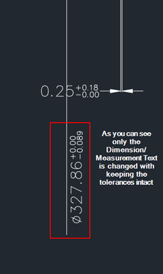

I want to override the dimension Text, with keeping the tolerances as it is. Is it possible?

I'm using Stacked Dimension to override the tolerances. I'm overriding the text as follows
\A1;%%c316{\H0.5x;\S+0.00^-0.36;
by overriding dimension text as above, I get the following result

Attaching the before and after images FYI
Before Image
After Overriding the Text, I achieved the following results
After Image
Message 8 of 9
_gile
It's still confusing. From what I see it is not "keeping the tolerance intact".

varad.keshatwar
@_gile
There was Some mistake from my side, I actually attached some other image. I've updated the images please check
